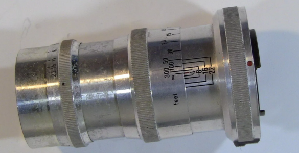

Hello:
I bought a 135 mm f/4 lens as described above, s/n 160???? (I don't have the number) which seems to be from 1935. It was sold without a camera, and I do not own a Contax RF. So I was interested for adaptation. I have a Singapore 40/4 Sonnar from a broken 126 camera that had rust inside the lens I have used on two different mirrorless cameras and it is sometimes my favorite lens (it's stuck at f/4).
Can someone please tell me whether there are multiple generations of Contax RF mount?
Thank you
Murray
I wasn't sure about the s/n table I found because there was gaps in numbers.
There must be some significance to being marked Carl Zeiss without a city name (like Jena), maybe they started that post-WWII? (Just a guess on my part).

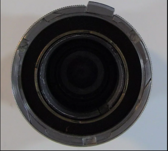

Hi Murray,
the broken 126 camera you mentioned was a Contaflex 126? This was actually a different camera from the Contax.
The Contax itself used to have the same mount from 1932 on until 1961/62: a kind of multiple mount. 50mm lenses are put into the "Innenbajonett" (i.e. "internal bayonet" - can be seen here). A lens like your 135mm is put onto the "Aussenbajonett" ("external bayonet", can be seen here).

This is a post-war lens. The pre-war and war-time lenses have quite a different design, and generally pre-war Zeiss lenses are only very rarely made from aluminum. This changed during the war-time due to materials shortages.
Since the serial is apparently 1.6million it makes it a Carl Zeiss (Oberkochen) West-German post war lens for the Contax IIa/IIIa from around 1955 if I had to have a wild guess.
The pre war version is chromed? brass and super heavy, no aluminum. And yes, the design is totally different.
Definitely post war--the chromed brass barrels never look this bad despite their age. But if the optics are in good shape it should be a good lens on a mirrorless camera.
Correction on the 126 camera...Rollei A26, 40/3.5, my first introduction to a coated Sonnar.

When it arrived I was suspicious about the bright fuchsia AR coating, because I took 160---- to mean 1935.

This lens has what I think should be called the external mount bayonet, and has its own helicoid.
Does anyone know if the Nikon-S RF adapter is compatible?
In particular I was looking at the K&FConcept one. Their clarification about internal vs. external bayonet is not entirely understandable to me. It sounds like the external mount will not fit this adapter.
"Allow Contax RF / Nikon S mount lenses used on Sony E NEX/Alpha camera body. (Contax RF Series allowed Internal Mount Lenses (not allowed External Mount lenses)" - not clear if this adapter allows/not allows, or they are talking about the Contax camera mount restrictions.
Thank you
From the pictures in the link that you posted, it looks to me as though internal mount lenses (50 mm) won't mount but external mount lenses (all of the other focal lengths) should mount. With a mirrorless camera, the focusing discrepancy between Zeiss and Nikon RF bodies shouldn't matter since you are focusing optically and not with a rangefinder. As for the quality and precision of the adapter, I doubt that it can be that great for that price.
