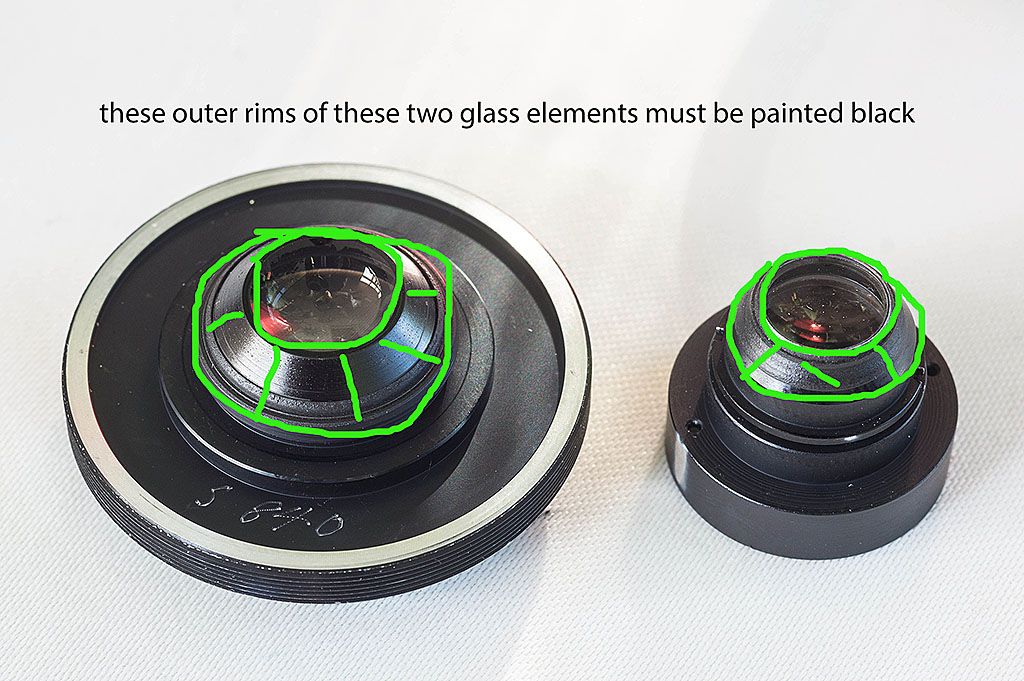

this lens develops a specific problem which probably effects more copies in circulation than not. I believe that the lens in the article you linked, with the very detailed instructions on how to disassemble, didn't have fungus but that very problem: the outer rim of the rear of two of the elements are painted black and this paint 'disintegrates'. If the paint is partly gone the lens will 'glow'. Furthermore this may lead to 'bubbles' covering the rear side of these elements in their optical paths and that also may influence IQ negatively. The good news is that the lens is easy to open, that these bubbles usually can be simply wiped away and the black paint repainted. I repaired one lens and later gave instructions how to somebody who had asked me for it. ( if I just would have known that linked article, would have saved me some work 😉 ) The photos I had prepared to help are still available, here the one where I show the two surfaces that need to be painted:
once you have it check the condition of your lens, if optics look clean or if you see 'bubbles'. see if you can make out if the outer rim is nicely pained black, one should be able to see that by looking at the lens from the front without having to open it, only the inner circle being clear and the rim around being uniformly black. if it needs attention and if you have further questions don't hesitate.
have fun, andreas

here a photo of the lens I had repaired after I had wiped away the bubbles ( unfortunately forgot to take a pic 'with' the bubbles' ) but not yet repainted the surfaces:
click on it to see it even bigger, one can clearly make out the lack of paint
