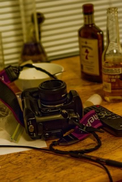

Not sure about the coding but this is my favorite Magenta picture...

Looks like a party. Liquor, bong, bag of weed, beer, camera and a bowl of cereal.cmogi10 said:Not sure about the coding but this is my favorite Magenta picture...

sleeek said:Looks like a party. Liquor, bong, bag of weed, beer, camera and a bowl of cereal.
Not my place! :angel:
