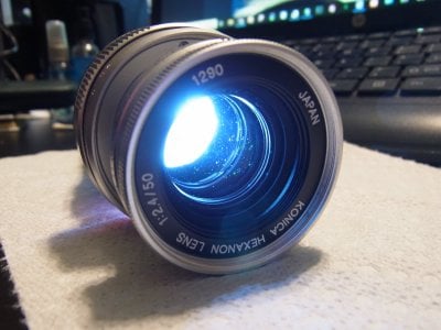

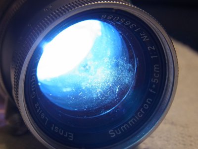

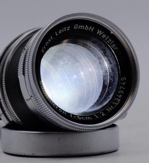

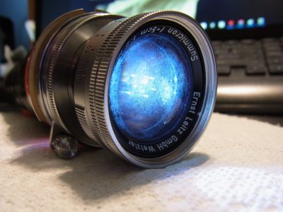

For $280, took a chance on a late collapsible Summicron LTM 5cm F2, sold as-is with the haze well photographed. The haze has penetrated the coating of the front element. Leica had soft coated optics in the 1940s and 1950s. All other surfaces are now clean.

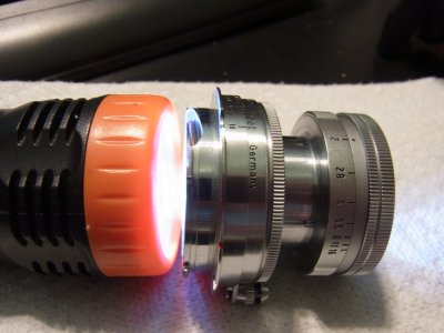

Shine a strong light through the lens, and the haze in the coating of the front surface shows up.

This lens, the surface looks much different- not cleaning marks, not scratches. It's interesting. Looks more like Bloom on my uncoated lenses.

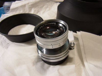

Interesting. My experience with moderately hazy lenses is a reduction in contrast. The collapsible is a low contrast lens already even with no haze. @Sonnar Brian could you shoot a photo of the glass backlit to get an idea how hazy?
This is the image of the haze from the auction. I can see internal haze that cleaned up nicely, and the "milky" front coating.
This is how the lens appears now, I used a bright flashlight that picks up everything.
Despite what you see- the lens produces the images as shown.
