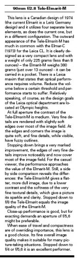

Here's what Putts has to say about it.
attachment.php
