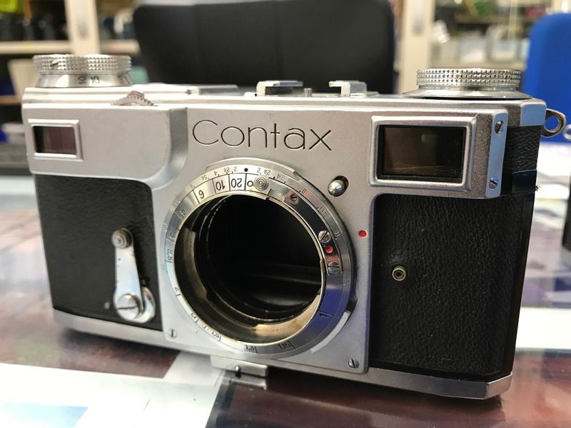

Thanks for all the support! I got the Contax II this lunch. it has a modified flash sync port in the front which I can just cover later on.:bang:

here it is

Very nice ! Second series model (rounder letters on the Contax logo).
As for the spool : the plastic spools from the postwar cassettes will be too short. In any case, a plastic spool is lesser than a metal spool.
I recommend you to get a metal spool for an early Kiev, identical to the original prewar Contax spool, easily available on the 'bay, and marked
Киев.
