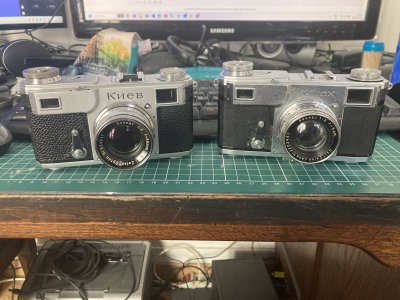

Last year I bought a 1939 Contax II on the cheap, it was not working. I sent it to Oleg who had to do a restoration since there was some rust inside. It cost me $300 + shipping, but I think it was well worth it, it's such a nice camera to use. I have not yet tested the Sonnar 2/5cm that came with it, but it looks a bit iffy.
