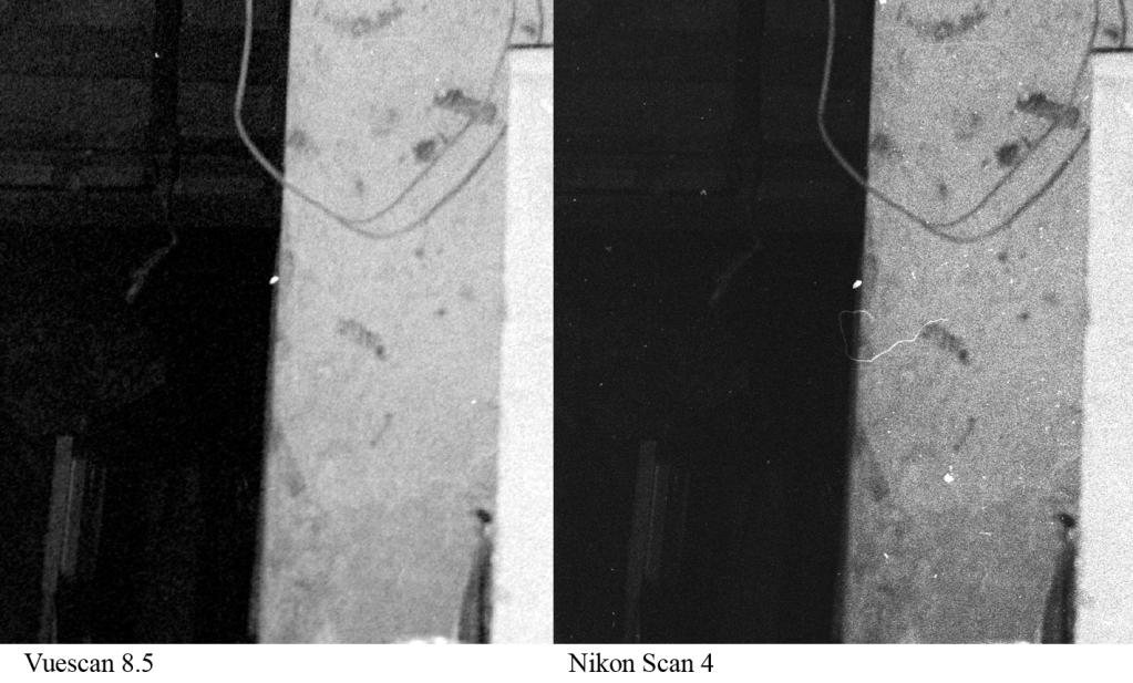

I need some advice, please, from RFF members who have experience of both of these software packages. I use XP2 and scan in the Nikon software at max resolution, 14 bit colour neg setting, but with only the ICE and GEM settings (set at 3) enabled, as I prefer to post process in CS3 or Lightroom. I have been experimenting with Vuescan to see if I can squeeze higher quality out of the negs, especially with the Vuescan multiple scan facility. My Nikon software scans are just miles better, so I just wonder what all of the hype is about. With so many members using it and being enthusiastic about the results, is Vuescan really that much better? If so, then clearly my settings in Vuescan are not delivering. I am scanning TIFF at 4000 res, 4 passes and dust and grain settings enabled at setting 'medium'. I am using colour neg as the setting.
Perhaps I have to wade through the 80 odd pages of the Vuescan manual, but I would be really interested to hear of other members experiences with the changeover.

<snip> I have been experimenting with Vuescan to see if I can squeeze higher quality out of the negs, especially with the Vuescan multiple scan facility. My Nikon software scans are just miles better, so I just wonder what all of the hype is about. With so many members using it and being enthusiastic about the results, is Vuescan really that much better? <snip>
Ray: are you making your judgment on "quality" based on the scans or on the final result after adjustment in an image editor? If based on what comes out of the scanner, not surprised you think the Nikon is better. That software is made for that. Sort of like a JPG from a digital camera. The final output is where you may see improvement with Vuescan. That is because you have the ability to insure the endpoints of the histogram are not clipped by the scanner software and you do all adjustments in your image editor.
I have been using Vuescan for about ten years and use settings that are very close to the defaults. I evaluate using the prints not what the scanner software outputs. I do make all adjustments in Photoshop, not Vuescan. I just insure the histogram is not clipped so the scan file is exporting all the data from the film.
Remember your scan quality is a function of the optics, mechanical alignment, and electronic noise of the actual scanner. The scan driver (Nikonscan / Vuescan) cannot improve on that, on degrade it. So you want to the scan driver to do as little as possible.
If your Nikon scans are miles better, then there must be something wrong with your Vuescan settings. There really shouldn't be that much difference in the results, although how you get to the best end point will be different.
I started using Vuescan when Nikon's software couldn't handle my OS, so it's been a while and I can't really give a direct comparison. One thing that I can suggest is to try turning off the multi-pass and multi-exposure scanning. The alignment is often very slightly off, and can soften the finished files. XP2 and the Coolscan V (hate that name…) are both good enough that you'll probably be happy with a single pass 98% of the time. It's also much, much faster.
Bob, I have been comparing the raw scans, rather than the final print. Frankly, I thought that this was a fair comparison, as I scan with the absolute bare minimum of options selected, like you preferring to post process in PS etc.
Having spent the afternoon running some tests, I have not changed my mind - the Nikon scans simply deliver a better (and bigger) file. When it comes to getting the blend between resolution and grain, Nikon scores. Having said that, I can see that there might be good reasons for the change, especially if there are are stability issues. Luckily, I don't seem to have that problem with XP.
