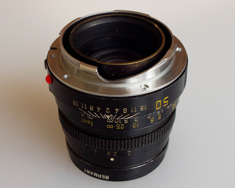

I hope this clarifies it. You can see where the brass is blackened, and where it was ground down:

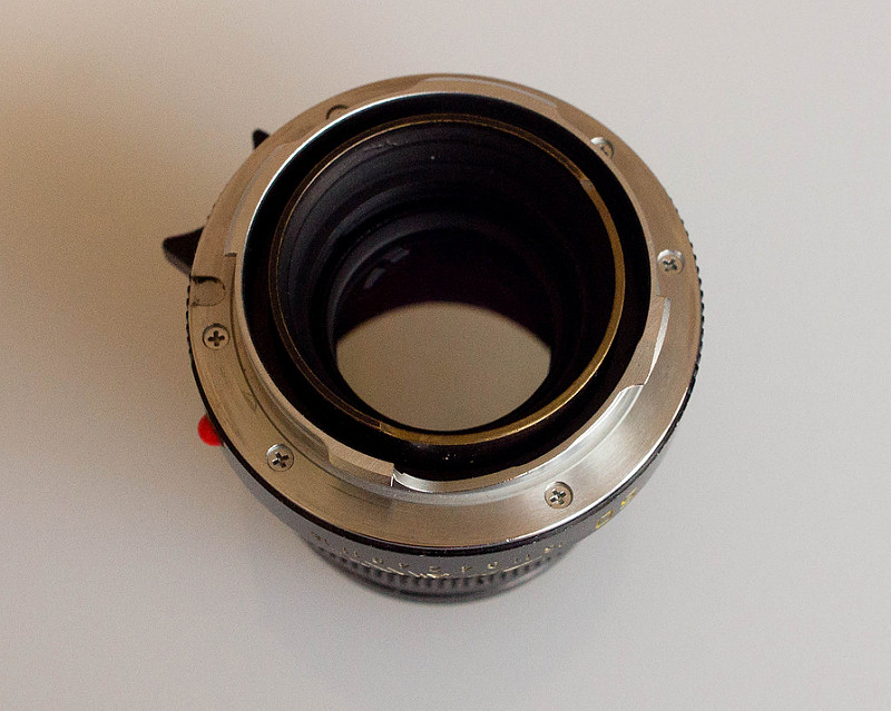

Anyway I have attached a few close up shots of the lens, let you guys to judge its condition. Btw it looks exactly the same as CNNY one..

The cut-out on the lens mount itself looks like it's been cut deeper, and none too tidily. Presumably that was done to allow extra travel for the R/F cam follower, to allow closer focussing. That may be what mislead the repairman.
This first pic is of the V3 at 0.7m clearly showing the ramp on the brass focus face and also uniform file marks to the chromed mount cut out. These same file marks are visible on my Summilux 50 v2 and also my 50 collapsible elmar which I know to have been untouched since leaving the factory.
