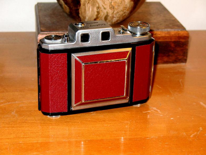

What the heck, I've got this one too:

Darn, that looks hot
What skin is that?

Plain old leatherette stripped off of an old book I found at a used book store. Spent about an hour soaking the paper and glue off the back of it and then started cutting it up. It isn't quite metallic, although it comes off that way in the photos.
Edit: Nobody was selling bright red leatherette that I could find online, so I had an idea and went to a local store that sells used books. I ordered some red leatherette from Cameraleather once, but it was nothing at all like the color in their photos. It was brick-colored and I was hoping for bright red (the photos on Cameraleather looked kind of salmon-colored). Anyway, I just ordered a kidskin hide in dark green, and that ought to look good on something too (maybe a Bessa or an Ikonta). I have a whole box full of black.
