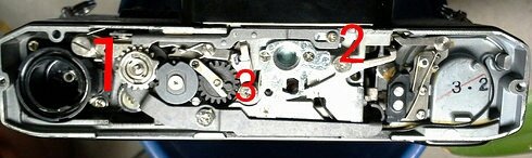

I think I may have re-synced the gears on my OM-10. Not sure what it was exactly that did the trick, but here is what I did:
I removed the bottom plate, tripod mount, and set the rewind tab to 'R'. I noticed that by pressing arms 2 then 3 (see photo), I could get the shutter to complete its cycle. Though once re-cocked and fired, the mirror again failed to fully return. At which point I used the tip of a jewlers screwdriver to manually turn the gear (1) that coupled with the winder 2. After turning this gear fully I again fired the shutter and manually completed the cycle. After repeating this process a few more times i noticed that the mirror fully returned after firing the shutter! Further clicks of the shutter seemed OK.
Maybe I just got lucky, but the real test will be to put a roll of film in and see what happens. Hopefully it works - it's in perfect shape and would be a shame to scrap it for parts. I hope this helps someone else out there with a hopelessly stuck OM-10!
