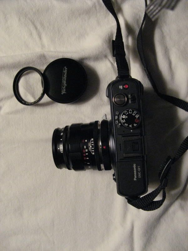

. . . . . I have also have a Voigtlander Leica M Lens to Micro 4/3 Adapter and Leica Screw Mount to Leica M Mount adapters for a Voigtlander 75/2.5 Color Heliar and Voigtlander 50/1.5 Aspherical Nokton.
. . . . . also ordered a adaptor for a Contax G 45mm f/2 Planar and a Contax G 90mm f/2.8 Sonnar. http://contaxgm43.wordpress.com/
It is a personal choice, I rather spend the additional money for the quality and how it looks on the camera.
GF1 with Voigtlander 75mm Color Heliarf/2.5 using the Voigtlander Leica M Lens to Micro 4/3 Adapter and Leica Screw Mount to Leica M Mount adapters.
