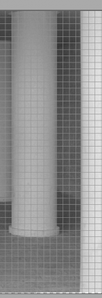

I skimmed my negatives really quick and found this example - it was scanned with a Epson v500, the negative is as far as I can tell perfectly flat. It was the 3rd out of 6 frames, so pretty much in the middle. It was shot with the 50mm f1.4 pre-ASPH 'Lux, which imo doesn't distort a lot (I never noticed, and I'm picky about those kind of things).
This is the original scan:
This is what's visible in Photoshops Distortion Correction 'Filter', it can be fixed with a value of +1.
Finally:
Finally:

Martin, good examples (and a nice photo, too).
