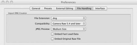

I agree with Ricoh on the camera part. What I don't understand though is what LR is really doing to DNGs.
There are numerous options in the tab Lightroom > Preferences > File Handling. Also, I have caught Lightroom making changes to my DNGs on several occasions without me having made any attempt to save the DNGs via the LR menu!
I have finally resorted to the following approach:
1.) Tag photos with metadata usuig ExifTool
2.) Copy the file to the pictures directory
3.) Import into LR using the settings in the attached picture.
You will note therefore that I save a DNG file that I do not process. LR may or may not be loss free depending on the import options. But, I am pretty sure that it *MAY* change the DNG version to a different version thereby limiting compatibility.

JP, that function you illustrated is, I'm sure, intended to offer the option of creating DNG files out of NEF and PEF, etc raw files upon import. All my digital cameras save their raw files as DNG either natively or as an option, so I don't need to do any conversions. Though others might, and that would be the only reason I can think of to use that DNG creation feature in LR.
Personally, I'm happy to let my computer's file system handle file management chores, and keep LR's sticky fingers out of it!
With a card reader, I connect my SD card to the computer, showing up as an external drive, and copy its contents to a new folder/directory placed on my computer along with others of its kind so I know where it is and can deal with it directly at will. I then direct LR's attention to its location in the directory and "import". But the files just stay where they are and are not affected in any way. LR just knows where they are and saves editing details in its own database.
Before this "import" I will bulk-rename the DNGs according to my filing system, and possibly also adjust their EXIF data to reflect use of a non-native lens for example. And this is also the time I'd use CornerFix as needed...
