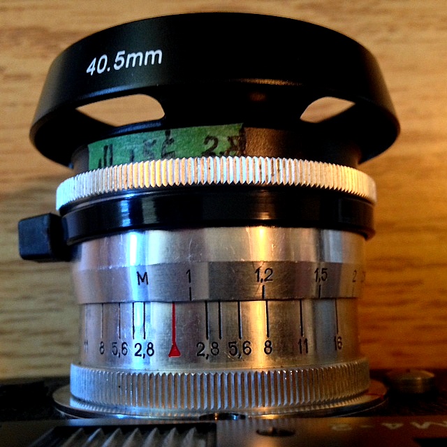

I have owned two Jupiter-12. IMO, they were better optically (except flare) comparing to overpriced Leitz Summaron 35 3.5, those I also have two and let them go as well. But Jupiter-12 was always driving me nuts with handling. Aperture scale is deeply inside of the lens front and aperture numbers, dot are next to invisible. On the street I was also getting my fingers on negative, because focus ring is on the front edge.
Adding of generic hood solved two and half problems. Flaring is reduced, fingers are not getting into the frame and adding of aperture scale on masking tape allows to set aperture normally.
I also added cable tie for fast focusing without looking at the focus scale.
This is my third Jupiter-12, which was given to me as gift from Russian RF Club member, forum moderator - Maxim Aleshin. It is made in 1950 and after CLA it is smooth to focus and solid in handling. I shimmed it for M, Jupiter-12 is most easiest lens for it and for CLA as well.

Internal hood which is acting as aperture ring is adjustable for how far it will go from the lens. On the lens I have shown here I made it seat as deep as possible to avoid vignetting with hood. But opposite is possible and it gives about four millimeters for the grip.

Mini size from http://www.lenstab.com/ will be more elegant, but if everything works (so far I have tested it on M-E only) I'm thinking of making tab from aluminium.
