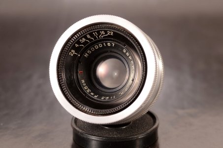

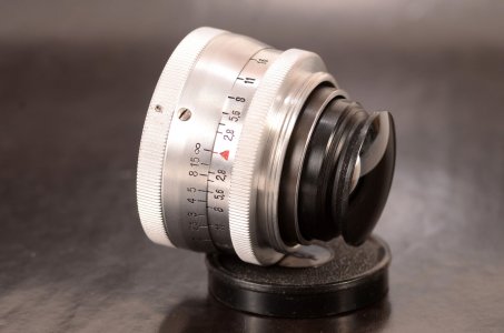

We'll start with my 1952 Jupiter-12, which is a Carl Zeiss Jena Biogon from 1943.
Early coated CZJ 3.5cm F2.8 Biogon on the Left, my $50 J-12 on the right.
It's in the book- the Serial Number is stamped on the rear element and is visible with the rear lens cap off.
Also note the thicker focus ring on the early J-12, the later lenses -that I have seen marked BK- have the thinner ring of the later J-12.
If a lens is being advertised as a BK Biogon and does not have the Serial Number on the rear group being displayed, DO NOT buy it- it is a later Jupiter-12. IF it is a Jupiter-12, and HAS the SN like mine- Grab it. It has Zeiss optics. This 1952 J-12 is as good as the Coated Biogon shown alongside of it.

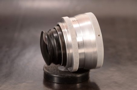

I bought a later 1960 J-12 off Ebay dirt-cheap, it was missing the front element. I had a spare from the correct manufacturer and time period.
The 1952 KMZ on the left, Zeiss optics. 1960 LZOS on the right.
Looking closely: the rear group is a different shape between the two, the KMZ rear most element is thinner. The J-12 was reformulated when the German glass ran out.
The focus ring on the KMZ is wider, note the distance from the set screws. The Phony BK 3.5cm F2.8 on Ebay looks like the later lens.

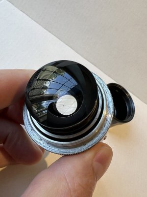

Also note: some J-12's in LTM have a collar around the rear group, like the original Biogon. I have seen this collar cause problems when mounting on cameras. Try to find a lens with an exposed rear group, as shown here. The collar will not be a problem on Contax/Kiev J-12 lenses mounted on a Contax, Kiev, or Nikon RF.

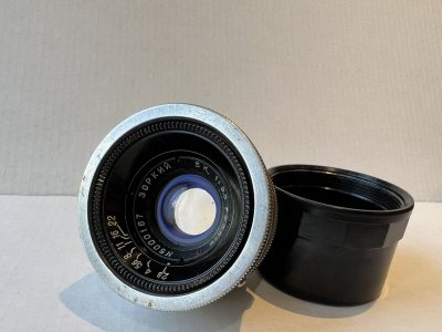

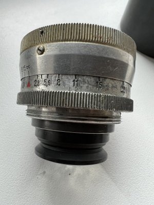

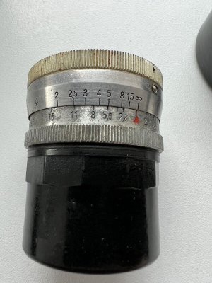

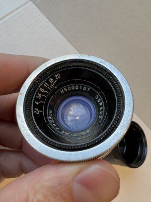

I had this e-bay purchase refreshed (full CLA) by a shop in Ukraine - before and after pics here. Would love any comment re originality! Based on the serial it seems to be one of the last of the reparations pieces in 1950.

That looks authentic to me: A Zeiss Biogon completed in Russia. I have seen a couple like it. One of those: the rear group jammed against the RF follower in a Canon III. It was a bit earlier. My 1952 J-12 has Zeiss serial numbers, works perfectly on the Leica M9- I suspect they worked the kinks out.

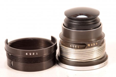

On my 1952 KMZ J-12, there are the last digits of the Sn stamped in the collar of the rear group. You can see them on the first picture in this thread. These relate it to a batch of Biogon lenses documented in Thiele's book on Carl Zeiss Jena. The internal numbers that you show were not documented, but were used by Zeiss to match pieces of the Helical. Nikon also gave separate seiian numbers to focus mounts early in their production- I have a collapsible Nikkor 5cm F2 with a SN for the Barrel and a different one for the mount.
When the lens comes in- look for a 5 or 6 digit number on the rear of the lens.

deltapuppy, congratulations on the BK, an authentic one is hard to find. I have been looking for a while myself, and have not seen one yet that I was sufficiently confident enough to buy. Either that or the lens elements were trashed. By the way, the WW2 era CZJ Biogons in M39 mount look exactly like your 1950 J-12

Thank you, Dexdog. Your further confirmation is again reassuring. My hope is that this lens and comments here can join an informal online body of legit inquiry, experience and example that helps counter some of the misleading or openly fraudulent listings. I'll post a further pic if there is an actual serial number on the collar as Sonnar Brian mentioned.deltapuppy, congratulations on the BK, an authentic one is hard to find. I have been looking for a while myself, and have not seen one yet that I was sufficiently confident enough to buy. Either that or the lens elements were trashed. By the way, the WW2 era CZJ Biogons in M39 mount look exactly like your 1950 J-12
