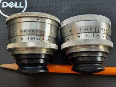

So my CLAd BK has arrived - no serial is visible externally but the rear element is clearly different than the 1963 example on the left. A difference in the width of the focus ring shows up easily in the comparison. I'll shoot and post some pics with each asap. It does seem though that the 1950 example does have the CZJ glass despite no serial.

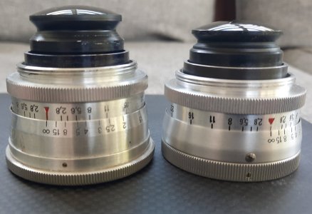

Bottom to top, 1950, 1951 and 1953 Jupiter 12s. The first two have alloy optical fixtures, while the 1953 is brass. I have long wondered about the metal collar around the rear elements, some have it, others do not, but I think most that I have seen on eBay do not have the collar. The first two lenses look exactly like a couple of my 284 series CZJ Biogons in LTM. My pair of 271 series CZJ Biogons in LTM have the metal collar.

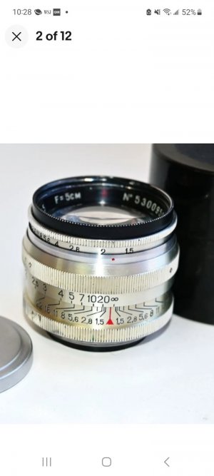

Is there anything approaching a consensus on when Zeiss Sonnar optical blocks used in ZKs ran out? An e-bay seller in Moldova has a 1953 J3 listed (s/n 5300950) with (modified?) text that I believe may have originated on the Sovietcam site stating "It is assumed that all lenses produced before 1954 are equipped with Carl Zeiss glass from reparations to the Soviet Union." I got a refreshingly straightforward reply from a Ukranian seller in Poland re ZKs saying " I’ll tell you more - there’s no point in looking for them for the sake of photographing. There are a lot of fakes, or broken glass in the original ones, or replaced glass.
It makes sense to just buy a Sonnar and be happy, it’s certainly no worse than a clone."
I think that 1954 is the consensus for when the Soviets ran out of glass from Schott that was taken from the Zeiss companies. I Have looked at that eBay listing, it is a good looking lens.
I have a 1956 KMZ Jupiter-3 that is a "v1", uses the German glass. KMZ changed the design of the J-3 rear fixture when moving to the new glass. The rear triplet is not interchangeable between V1 and V2 J-3's, or between V2 and 5cm F1.5 CZJ Sonnars. Production of the V1 and V2 J-3 overlapped for a while, maybe the elements were manufactured and waited to be mounted.
