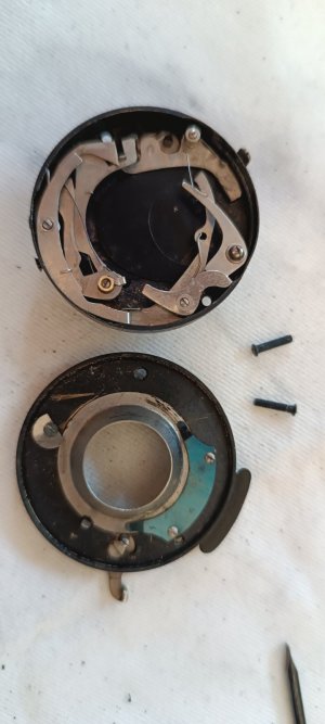

So I got this little camera some time ago.
I planned to fit an Instax mini to it's back. That would fit almost perfectly.
But I discovered the shutter speed is limited to about 1/50. The other speeds don't work.
So I opened the shutter to see if I could fix that.
The speed shifter results in a little peg that sticks between the chromed parts, just to the left above the brass ring on the photo.
I can get what it's supposed to do, but it just doesn't work.
Anyone familiar with this kind of shutters?
