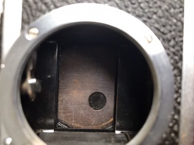

Recently I got a beautiful Fed 1 (apparently C) and under closer inspection noticed a hole in the film pressure plate. Does it serve any purpose or is it just a manufacturing fault?
Any ideas?

Probably it is from a Leica.
Perhaps you have ever looked at the back of an early Leica. In the middle of the vulcanite, you can often see a small round metal area. If you remove the lens from the camera, you will see a round hole in the film's pressure plate. Through the hole you can see the slot of a screw head. That is the front of the small plane visible on the back of the Leica. With a screwdriver, you can unscrew the metal plate out of the back of the camera. Of course, this will create a hole in the cameras back. If you put a transparent piece of film in the camera, put the camera on a tripod, and look with a magnifying glass through the hole in the back panel you can check if the focus point of the lens is on the right spot. Don't forget to put the round metal plate back when the checking is finished.
Erik.

I can't open .ru sites at work to find out in details. But this is known for earlier production. Not fault.
That is even more interesting. Did Fed copy the hole just because Leicas had it or did really early Feds exist with the „metal area“ on the back that can be accessed through the hole in the plate like with early Leicas?
Since it is a pre war camera the plant probably didn’t use german parts like in Jupiters and Kievs. This particular camera has spent almost its entire life in the „west“, so could have been repaired with Leica parts.
Early (by which I mean pre war) Feds had the collimation hole in the back and other Leica like details like the 'kick' in the viewfinder window.

This is a hidden opportunity to align the camera-lens bundle))), similar to the current hidden features of Windows and iPads)))
The reason for the hole on early Leicas is that the early production run wasn't standardised - every lens needed collimating to the body it was intended to be used on. It was only with the introduction of the Leica Standard in 1932 that this practice was no longer necessary, but FED bodies and lenses weren't standardised until much later. I've never handled a pre-war FED - only the (really very nice) lenses - but I assume they'd all have and need the hole for the same reason.
