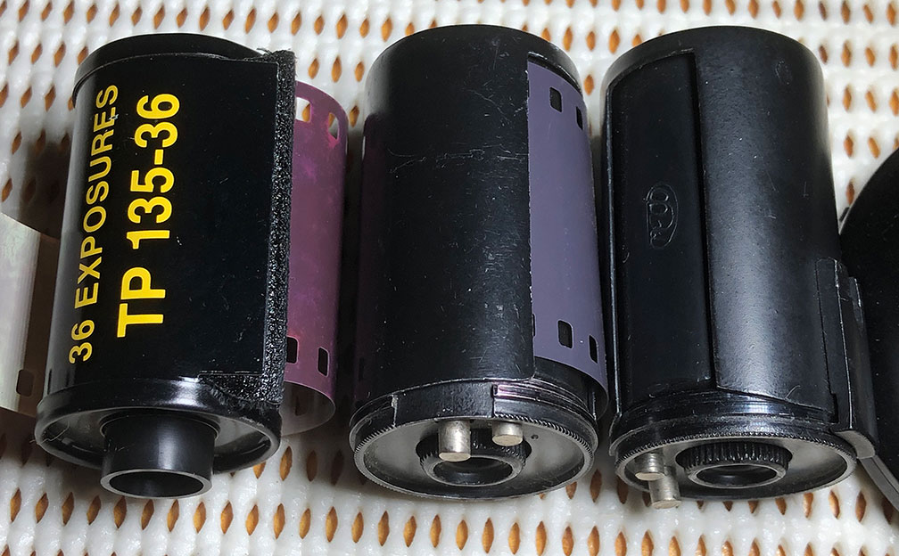

I keep trotting this one out but here we go; old cassettes were bigger than Kodak's cassettes and we went from loading the old cassettes that fitted properly to using Kodak's and all the others. So they slop about but a washer or two cures it.
Some say a washer each end and some say a bigger one just one end.
Here are a few side by side:-
Here's an old and new one with the film aligning them by running from one spool to the other.
Regards, David

In my experience you can't use any of the Leica or Zeiss cassettes, as they don't have the latch on the outer case that engages a pin inside the Fed film chamber. You can see the latch arrangement on the right hand genuine Fed cassette in this shot.
John Mc
