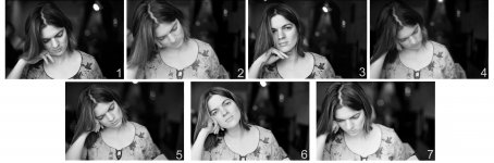

raid said:
I encourage people here to post images taken by any of the lenses [same type] I tested. Maybe we can see similiarities or differences.
I thought I'd post this little test I performed earlier this year, although it's in B&W, so that we have all in one-easy to access thread (link for the curious):
1: 50mm J-3 f/1.5 @ f/1.5
2: 50mm J-8 f/2
3: 50mm Summitar f/2
4: 50mm Summar f/2
5: Canon 50mm F1.2 @ f/1.5
6: Canon 50mm F1.2 @ f/2
7: 50mm Zeiss-Opton Sonnar f/1.5 (Contax mount) @ f/1.5
I hope some time not so far in the future I'll test all the above again, including the Summarit, the Summilux pre-asph, and Helios-103 53mm f/1.8

Gabriel: Thanks for posting your test results. My first results posted in this thread are in B&W too, so comparisons can be made. There is a need to carefully do testing again and again to get at the differences due to lens design and performance and those due to human error.
