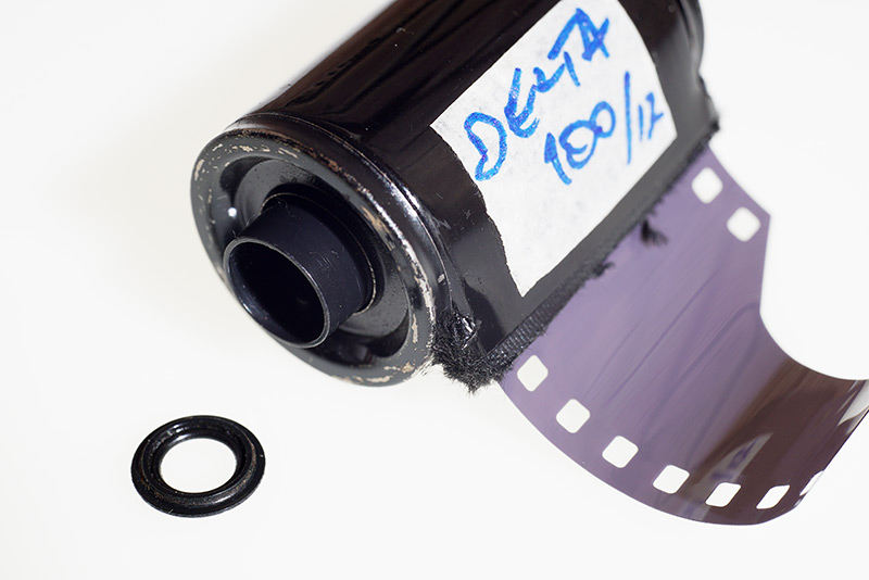

I purchased a Leica IIIf last year and threw in a roll of slide film to check it out. I discovered the curtain was riddled with holes but the shutter seemed fine and the images looked fairly sharp. So I sent it out and had a full service, which included a new curtain and rangefinder parts. I was very anxious to try it out so I loaded it without trimming the leader. It was a pain but I thought I did ok. Well it turns out it wasn't, and after I shot most of it, I get an email from my service guy saying he sent me his bottom cover by accident as he had his camera out for reference. Here are all the issues I had with my first roll.
  1. Film not trimmed for easy loading
  2. Wrong bottom cover (doesn't have film guide)
  3. All images are into sprocket
  4. images are not parallel to each other
  5. Forgot to take my lens cap off for 8 images
  6. all images look unacceptably soft
Here is a shot showing the two frame issues.
Hopefully trimming the leader next time and using the correct bottom cover will correct the frame problems. However I do have my reservations about the frames not being parallel. Also when I loaded the second roll I took off the lens and held open the shutter. When touching the film in the middle of the frame it appeared there as a bit of a gap. It is maybe .0001" however it seemed tight against the sides of the frame. I didn't notice any weird focus issues, other than everything looked soft so maybe it's the lens. It has a slight amount of fog and some scratches. Problem is I don't have a known good sharp lens to try in its place.
Focus was on the throttle levers which look very soft to me.
With a good lens I should be able to read the small type. Cant even make out my cats hair.
