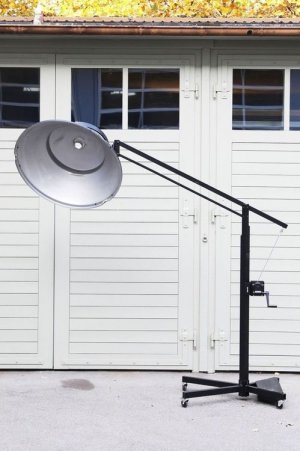

Don't be fooled by the Flamingo- and Mini-Flamingo stand! They are different!
The discontinued Flamingo stand was developed for large modifiers as Hazylight and Cumulite in mind!
The Mini-Flamingo stand is a bit smaller and accepts lamps with a Junior pin as for example used on a Satellite Staro.
I am pretty sure the Flamingo Stand can fitted with Mini-Flamingo Junior pin receiver...

FLAMINGO stand
MINI FLAMINGO stand
