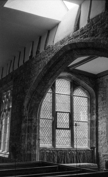

This week I took delivery of 17m of Retropan 320 and had my first attempt at bulk loading.
I shot a roll using an OM2 with the 50mm1.8 in automatic mode.
Processed in Foma Retro Special developer - following the manufacturer's instructions faithfully. Dev 4' 30" at 20C. 30 second agitation to start then 10 seconds per minute.
The images below are scans with minimal adjustment in Lightroom.
I hope this helps anyone considering trying this film. Shame it is not available in 120🙄
Good luck
Andrew

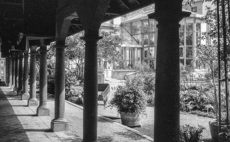

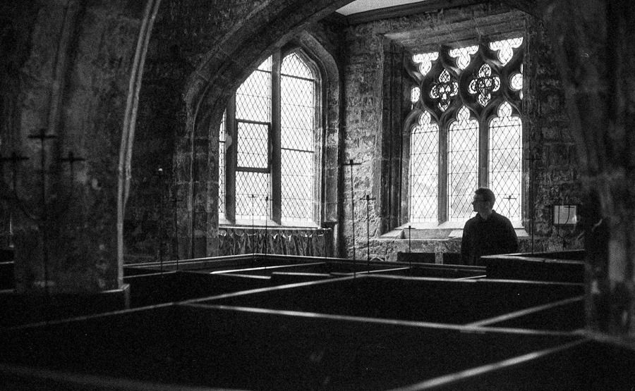

Second week with this film. These were shot in late morning full sunlight. Leica M6 with 40mm Summicron C.
Same processing as roll 1.
If anyone has experience with developers giving finer grain I would be interested. i like the tonality but not the grain!
Thanks
Andrew

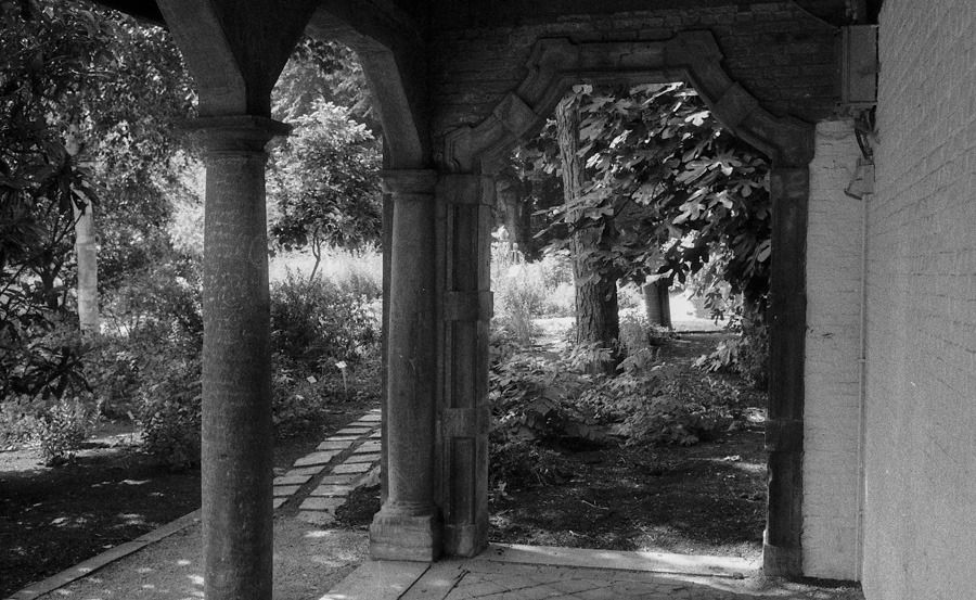

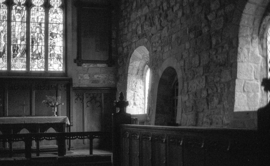

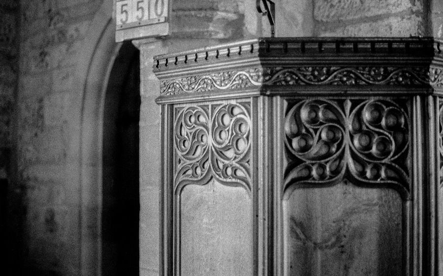

I shot another roll today and tried D76 stock at 20 degrees for 7 minutes. Agitate for first 30 seconds then 5 seconds per minute. Here are some of the results - negs a bit thin - see what you think.
