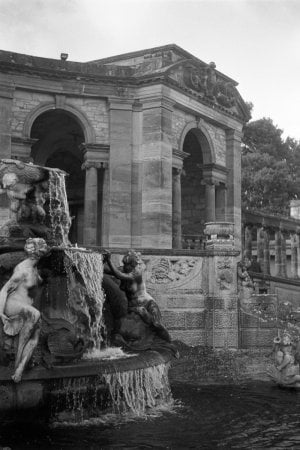

I think this was the last roll I stand developed (XP2, not Fomapan):
This sort of streaking was far more common than I'm happy to tolerate. I then dialled in a conventional development routine for XP2 in Rodinal and never looked back.

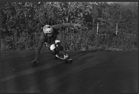

With regards to Fomapan 100:
This was with the standard recommendation of 8:00 at 20ºC and Rodinal at 1:50 dilution, 10/15 seconds of agitation every minute. I don't see a need to deviate from this. Blacks are lovely, mid-tones have good separation, highlights rarely look blown out, and grain is present but unobtrusive. I'm a big fan of that combo. It's a lot faster than stand developing for an hour, too!
