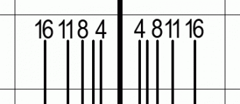

I just finished making a DOF scale for my Canonet. I would put it on my webpage, but don't have any at the moment time. So I'm placing it here.
Just save the attached image file, print on a sticker at exactly 600dpi (!), cover with transparent tape, cut and place on the lens barell - on the thin part between focusing ring and aperture ring. And you've got a DOF scale :cool:
Enjoy :D

I'll be doing this later! Could you confirm the print size should be:
width 1.6 cm
height 0.7 cm
Also how did you calculate the depth of fields?

Well, how I did that?
I put an empty sticker on the lens, marked positions for hyperfocal distance at f16(3.5m) f11(5m) f8(7m) f5.6(10m). Then took the sticker off and measured. Drew everything in PS.
Printed, cut, placed, works :D
BTW: some more in-depth info:
mark at f16 is 5mm from the centre, f11 is 3.5mm (5mm / 1.4), f8 is 2.5mm (3.5mm / 1.4), f5.6 is 1.7mm (2.5mm / 1.4).
funny, but it works. originally I measured it, but found the rule empirically :) I knew that the distance between the marks for f16 and f8 should be in ratio 2:1, the same for f11 and f5.6, f8 and f4 etc.
before I had the same thing but hand made... now that I did this digital version I thought it might be helpful also for the others at RFF.
before that I made a dof scale for my SLR lens Tokina 19-35. and before that I made a distance scale for Canon EF 50/1.8 :rolleyes:
PS: I also have a sticker with focal lengths on the retractable (read collapsible ;) ) lens of my Canon PowerShot G3. Just to be able to set particular focal length like 50, 85 or 100 :cool:
width 1.6 cm
height 0.7 cm
Yes, right.
I put mine in on the inner barrel of the lens - the portion that extends/retracts when you focus. There is a thin gap where you can tape the DOF scale to.
You align the centre of the DOF scale to the focus mark on the body.

I have attached a picture to show the placement of the DOF scale on my Canonet. I printed it on an avery label using photoshop at 600dpi as the author stated, cut it out and it matches the iDOF app hyperfocal distances very closely. It was relatively easy to apply to the groove in the lens barrel using a pair of tweezers, aligning the center with the focus mark on the camera body.
