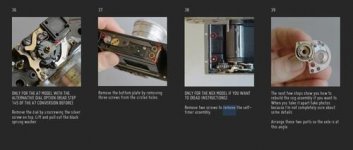

I had a quick look, and so far he's posted maybe 60 pages of tear-down on the A7 and M3. Really clear instructions but nonetheless scary. It is mad but pretty awesome.
Here's a snippet so you can judge for yourself how well he's presented all the work. Very impressive.

Cool, I was thinking about this project just the other day. That's some very clever work! The APS-C back based on the NEX looks more practical to me, but the ingenuity of the A7 modification is amazing.
