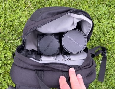

First time out with the Fuji GX680 III. As it is a monster, finding a relatively easy way to transport it was important. The camera fits well in the bottom of a Lowepro Fastpack 250. A model I or II might not due to the bulge of the battery pack on the side. The III can use the battery pack or it can be powered by CR123As in the base of the camera.
Lenses fit in the top section putting them side by side and film/meter and such can fit in the front of the top. This rig is around 25 pounds or so not including a tripod.
I'm currently printing a holder to keep them from moving around.

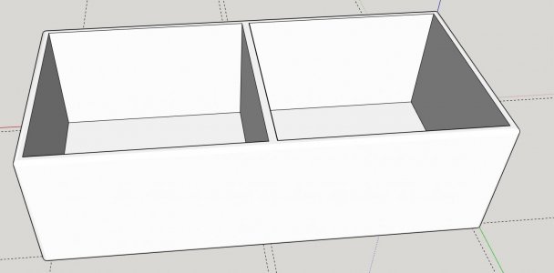

Lens holder finished printing. May make an add on to the side to hold my light meter, there is enough room in the backpack.
