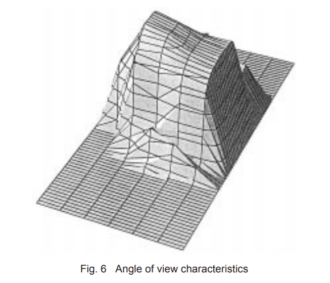

According to the manual of the XPan (which is the same, can be found here) the measurement mode of the XPan is a "centre-weighted" average reading and measures a field of approximately 20x30mm in the center of the shutter plane. This is the same for all lenses. Since the 30mm has a wider field of view, less of the image is taken into account.

It' center-weighted TTL, reflected off the pattern on the shutter curtain.
The default metering pattern, likely with the 45/4 attached.
Since the pattern is fixed, common sense would suggest it become a semi-spot meter with the 30/5.6 mounted.

It center weight meters from inside the 'regular' 35mm frame lines, not the pano frame lines.
OK, now I understand. I need to be far more careful metering with this camera than any other in my collection. That's a large portion of the image not metered!
