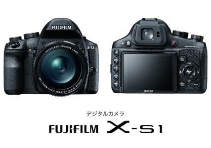

I've decided to start this thread as there isn't already one.
This week I bought a Fujifilm X-S1 and I'll be putting bits of info here that I find out in the next few days or weeks, in case anyone decides they may be interested in buying one.
As promised, here's a few bits of info to start off with:
1) In Manual Focus it's easy to support the camera with the edge of your left palm, support the zoom ring with your thumb and forefinger and still turn the focus ring with the second finger.
2) Manual Focusing isn't "very" easy at the wider end of the zoom, and checking the focus using the "Manual Focus Check" image isn't as easy at it could be as the image slips out of focus either way a bit too easily, Focusing and checking focus is easier at the long end, except for the extra wobble and blurred image until you've steadied the camera -even with image stabilisation on.
3) There are five levels of "Noise Reduction": Low, Medium Low, Standard, Medium High, High.
4) You can adjust "Highlight Tone". There are five levels: Soft, Medium Soft, Standard, Medium Hard, Hard. at a "Dynamic Range" of 100 (which can't be lowered in any mode), a preliminary look suggests that the differences between the "Soft" and "Hard" are very subtle.
5) You can adjust "Shadow Tone". There are five levels: Soft, Medium Soft, Standard, Medium Hard and Hard. Again at a "Dynamic Range" of 100 a preliminary look suggests the difference between "Soft" and "Hard" are very easy to see.
I shall be doing a few shots to experiment.
The "Standard" info in the viewfinder/LCD panel is generally arranged along the top and bottom, with the various Warning signs appearing about halfway up and slight towards the focusing frame. It is possible to customise the display, although oddly, even though I've got "Exposure Compensation" ticked, it doesn't show up on the display when in Aperture or Shutter priority, it does in Manual. However, when in Manual the display doesn't get brighter or darker as you change one of the exposure settings. This also doesn't happen in Shutter or Aperture Priority, However, the display does change in brightness when in either of the latter modes and you pressed the "Exposure Compensation" button and turned the command dial, which alters the control that is not the mode you are in eg. in Aperture Priority, AND using "exposure Compensation" the command dial changes the Shutter speed and you see the image changing Brightness.
