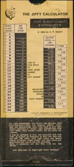

According to my Jiffy Calculator (snipped from Popular Photography in about 1967-my Yashica D days) a moonlit landscape on 3200 speed film takes ¼-sec@f/1.7 or approximately EV3.5. If this is accurate (and it worked for me and my Yash D), a Lunasix meter should read the exposure. You will need to use a small flashlight to read the Lunasix.
