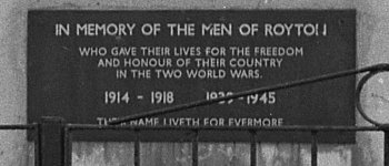

I've had chance to run a roll of HP5+ through the Moskva. Past attempts at using the body mounted release button have, I believe, added to movement in the lens assy as the resistance pressure of the shutter lever is overcome. This is all the harder at 250th. So it seems that using the self timer is the gentlest option for me at present, although I do take your point about using it at 250th, this speed I will avoid.
The roll came out very well, excusing one double exposure and one blank exposure (where I wasn't sure if I had made an exposure so wound on..:eek: .)
Only throw away shots to check for focus and sharpness. It is very promising indeed given the flat lighting on the day.
No light leaks, the tape over the red windows doing its job nicely :) .
It's worth doing a CLA on the camera, the slowest speeds are a little sticky and I suspect that the lens assembly is not quite square to the film plane, so will need some work (although i now wish that i had tried a few frames to check if this is a problem). It will need some thought too, it's not clear what to move/pack to get the lens assembly square-on.
Edit, a further scan at 2400 shows the text of the plaque is breaking up with the grain. Hmm, maybe this is well worth the effort to sort out the problems..

Dave, that's a darn sharp lens on the Moskva 5, probably a Tessar design.
