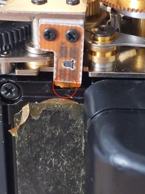

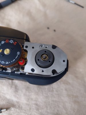

So I figured out what the issue was and broke something else in the process (story of my life).
I followed this guide on how to remove the top cap:
There was a piece of dirt stuck in the grease of the winding knob gear. To get a good view, I had to remove the plate above it. Of course, this was also holding down an extremely flimsy ribbon cable!!! I tore it with an accidental gesture. I reassembled the camera and put in a dummy roll. The sensor at the end of the ribbon cable is to detect the state of film advance and tell the shutter it can fire when the release is depressed. Now that the cable is broken, I press the shutter release but the shutter does not fire. I can then advance to the next frame but the film is of course not exposed.
I'm going to start emailing for a replacement but if anyone has a history with getting GF670 parts, please send me a message!!
