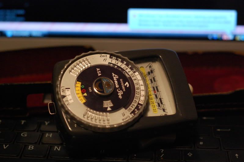

I have an old Gossen Luna Pro and I meter my rangefinders with it. it doesn't need to be like something of star trek for my simple needs 🙂 it doesn't let me down and has the same vintage appeal as the rest of my kit, although as it's battery operated and not a selenium meter it isn’t due for extinction 🙂 you can pick up meters like this relatively cheaply on eBay that'll do the trick! I would guess you'd use your 5D for those really tricky shots anyway - or at least have it with you in those instances?
