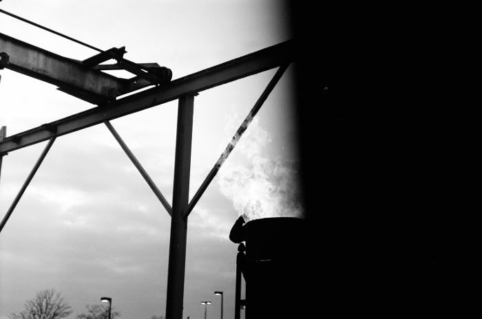

A few months back, I received a roll from the lab. The last 15 frames looked like this:
Extreme capping. Today I broke out the repair tools and some curtain material. Before I started, I removed the lens and the back and fired the shutter at all speeds pointed at my CRT. Nothing wrong with it. Nada. Nice even diagonal stripes at all speeds. No capping, no banding. Perhaps I was the victim of a passing gremlin that stayed a while and moved on to a more expensive camera?

If it ain't broke, don't fix it. Just before my bad roll, I had patched the curtain. I'm thinking that I may have introduced a piece of crud into the mechanism during the patching that worked it's way out.

Slide a white card into the film plane and fire the shutter starting with the highest speed first and see if you can see the entire frame..
I can. Wouldn't the CRT test show any irregularities of curtain travel if they exist?

I've never tried the CRT test so I can't comment on it..I've always used the white card..
