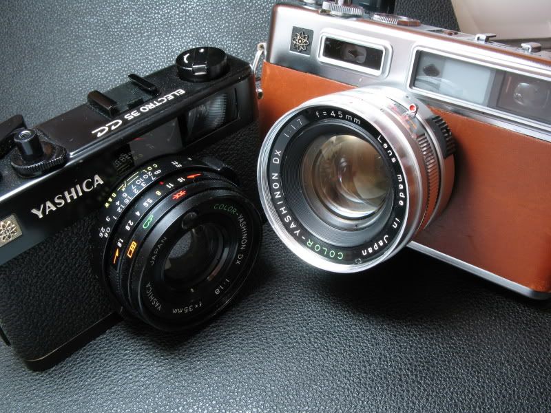

and a CC next to a GSN:
Thanks so much for the responses guys! I ended up being able to find a photo on flickr with both the CC and the GX (along with some other cameras). You can see it here: http://www.flickr.com/photos/28190275@N03/3348901439/
Seems as if the CC is just a smidgen smaller than the GX, although looks can be deceiving.
