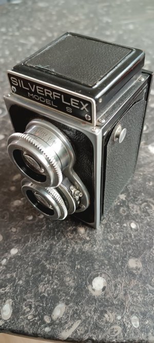

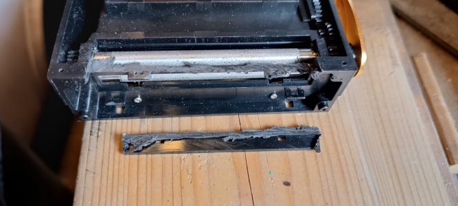

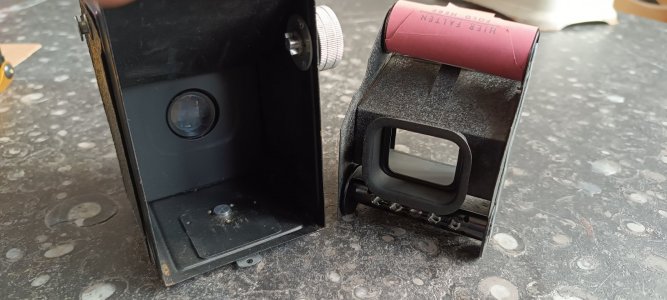

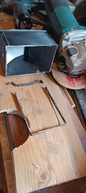

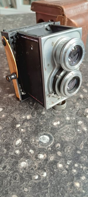

Here's my Silverflex. An early '50s copy of the very much similar Ricohflex. I mounted a Jollylook manual wrench Instax Square to the back. To achieve infinity, I had to cut about 4mm off of the back of the Silverflex. These cameras are very simple box TLR's, so no serious hardware is lost.
Picture made with this SilverStax coming soon!
