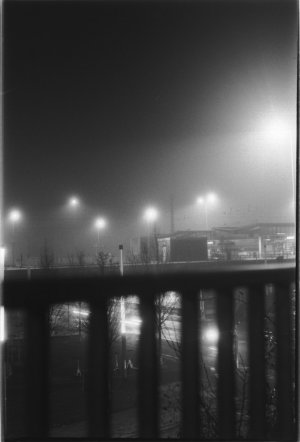

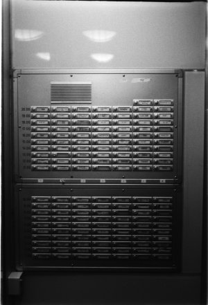

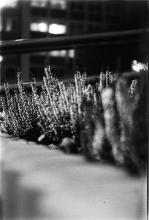

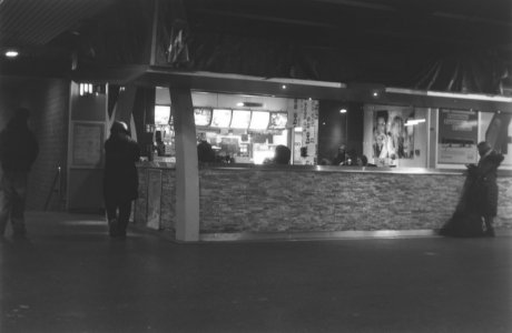

Had to push Fomapan 100 to 1600 using Rodinal. Here are some results
fub
11:26 AM
Dec 3, 2025
129
Germany
Went to the local christmas market and all i had was a bulk roll of fomapan 100. I made two rolls that i had to push to 1600 to get 1/30s on my trusty Fed-3 using an Jupiter-8 F.2 lens. I was messing abit with stopping down the lens to F2.8 and F.4 but i think all the pics i took on i.e. F.4 and 1/15s came out to shaky. Next time i will stick to 1/30s and F.2 and increase shutter speed, rather than stopping down the lens. The Jupiter-8 does a pretty good job wide open.
I was using Rodinal since it is the developer i am most familiar with and for comparisons sake to other Foma 100 pics. I have some XT-3 at home and will do another test using that developer.
The results were a bit surprising. Common internet-knowledge is that Rodinal is not good for pushing and that Fomapan 100 is not good for pushing. The results are grainy but for me totally usable. I was not expecting that to be honest.
Dillution 1:25 for 22 minutes at 20°C
Happy Holidays!

Nice and very interesting results.
The Foma 100 is certainly not known for being pushed, I used it up to 400 ISO with satisfactory results for me.

Dafür kommt das oft bemängelte Glühen des Filmes gut zur Geltung 🙂

1600 might not be really professional graded. even though the picture of the half closed champingion saucen shop turned out very good i think

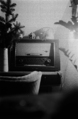

i did some more tests! i shot another roll at that christmas market with same development (still have to scan it) and a test roll on my new to me 1938 Welta Weltini with a f/2.8 Tessar. I basicly shot wide upen at 2.8 and at 1/25s to still be able to shoot without tripod. Not sure if that is still Iso 1600, it is just the most light possible for that camera in my hands.
The development was changed to two stand developments at 1:100 each. Basicly just refill the tank after 60 minutes and start again. i noticed that that way i can get ok results if there is a picture that would be totally overexposed for the 22 minute 1:25 development. There were some shots on the 22 minute roll, that were just insanely overdeveloped, because i was able to put the camera down and use 1 second shutter. On the stand development roll i also did some f/2.8 at 1 second shots which were not that were still ok in terms of overdelopment. With 22 minutes they were unusable.
Here are some of the pictures:

Jupiter-8 50mm.jpgsame shot with same lights but exposed and developed for 100 iso (also using Jupiter-8 at f/2)
dim lights at house entrance. very grainy at f2.8 1/25s
if there is no direct dim light, it is not working at 1/25s

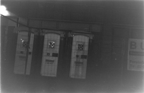

these shots were taken at 1 second and f/2.8. the last one was on a roll that was developed using 1:25 for 22 minutes, the others were on the stand development roll. Stand development wins big imho, because if there is a overexposed (for iso 1600) shot on the roll, it will not get crushed to looking like a 110 film crop

you can see above by the picture of the portable toiletts what happens when one is not critical of the scene and just shoot right away. it does not work.
