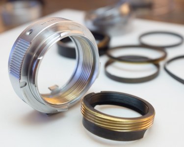

I'm certain that I've got the Leitz helicals as clean as they can be. Below are images taken when working on the DR (not the best focus, sorry):
I'm thinking that I need to use a different grease for these lenses, but I'm not sure which one. Based on your experiences what grease would you recommend? Does brass vs aluminum really make a difference?
