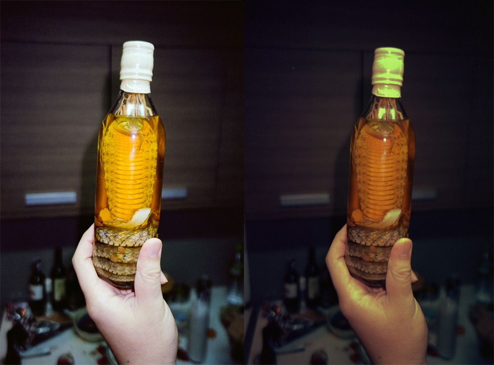

My Minolta Dimage Scan Dual IV started scanning strange tonight...
I'm so sad....I have only had this thing for less than 6 months.
I never had a problem with it before and even just two days I ago I was scanning with no problem.
However today I came back from the lab excited to scan my latest negatives and now everything is blown out with a green tint. I've checked all my settings, reseted to default and even loaded custom profiles, all provide the same result.
Here's an example:
(BEFORE - left / AFTER - right)

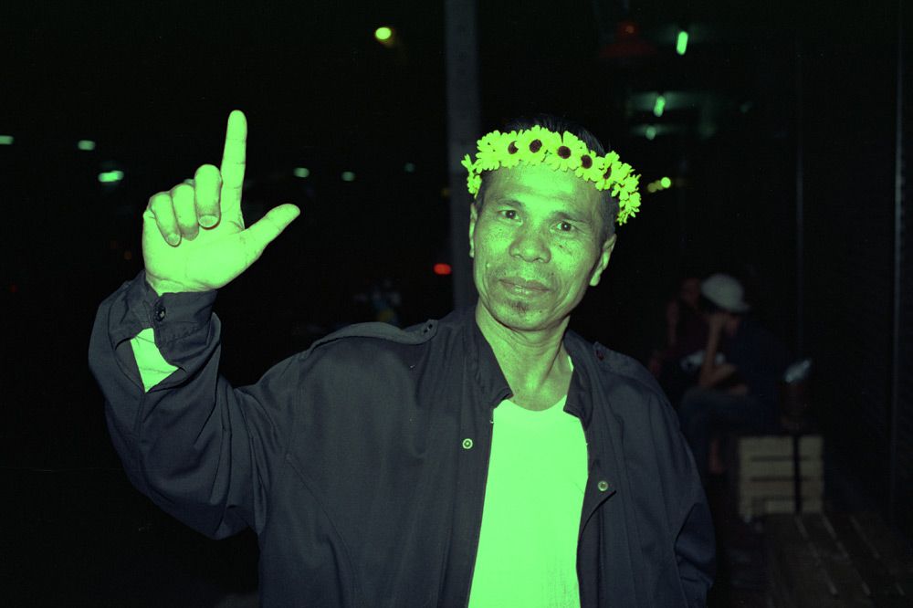

And here's another example:
They are scanned using Vuescan. I used the same application to scan with my Epson V500 today with no problem at all.
Has anyone else had this problem before?
Were you able to fix?
What do you think it could possibly be?
If anyone knows how to fix this you'll be my hero.
However, I fear it may be a hardware problem.
Any and all help is appreciated, even if you have only a faint idea.
WHOA! So apparently it's working fine again again now.
I unplugged the power cord, plugged it back in both in the wall and in the unit, everything is back to normal now.
Strange, but happy.
Hope it lasts!
