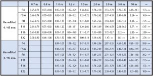

Do a search in google for "hyperfocal distance focusing" ... great for landscapes as you get the best depth of field for your chosen aperture. Its easy to do and doesnt require using the RF patch at all. All my work is shot using this method...If your shooting landscapes where you want EVERYTHING sharp, this is your best way to go!!!
