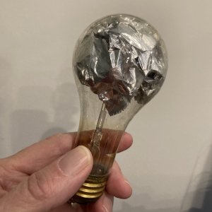

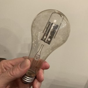

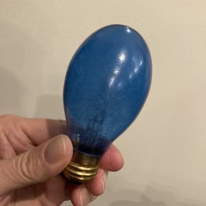

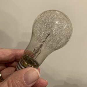

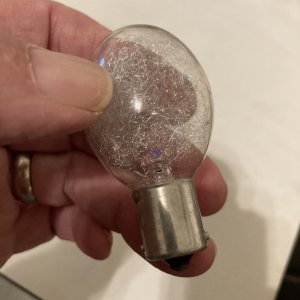

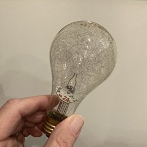

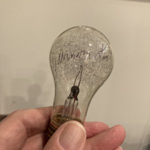

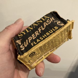

I pulled out a few flash bulbs today. Probably most of you have never seen any of these.

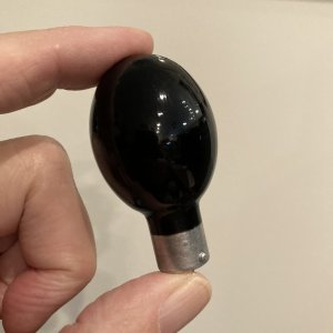

These are a bit unusual. The black one is a GE 5 IR that’s infrared only. The second is a #31 probably from the20’s or 30’s. I believe the material inside is a magnesium alloy. And the last is an FF33 with a 1.75 second peak used for ultra high speed motion picture. I used them to light things I filmed at 44,000 frames per second. The Shutter-Speed was 1/100,000 of a second.
