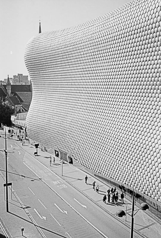

OK so I've tried scanning as positive and inverting in photoshop - though my version is the cut-down Elements 9. Then Ive scanned as neg. First is the positive scan:

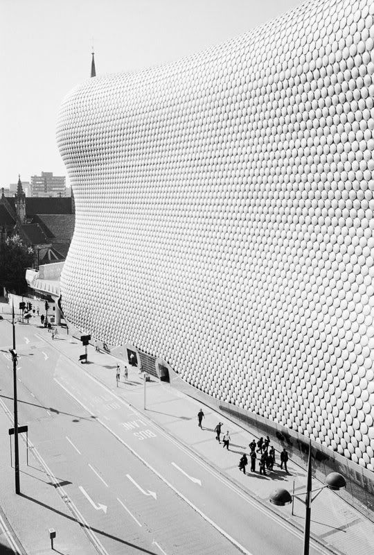

Now the negative scan:
Both have been post produced and contrast/brightness tweaked. There's not a curves adjustment that I can find in PSE just sliders. Thoughts? How do these compare to your scans?
An example of the kind of mushy shadows I'm talking about is this - it seems that its very difficult to get clean blacks and still retain a dynamic range without making everything too contrasty and also grainy. There are plenty of variables I can change, and perhaps PSE isnt the best?? But I'm sure I should be able to get a better result from this neg than this version -

The positive scan is a better starting point since it doesn't blow the highlights like the negative scan did. Part of your problem is using PS Elements. You NEED curves to work with film scans because you need to be able to increase midtone contrast along without pushing the light and dark tones off the edge,which is what the levels sliders in Elements do. There are free curves plugins available on the net for Elements to add that functionality. Google it, I can't remember where they're at. That'll keep you from spending $600 for Photoshop just for one tool.
The images you posted of the store with the funny architecture are badly oversharpened too. That causes the halos around places where dark and light tones meet and distorts the overall contrast too. Another problem is you shot them in harsh contrasty sun. Those kind of negs are the hardest to get good scans from. When I shoot in conditions like that, I reduce the developing time 20-30 percent (the amount depends on the film) and increase exposure one stop. (reducing dev time causes a drop in the film's effective speed). This lowers overall contrast, making the neg scan easier and keeps the contrast manageable. If you shoot in very contrasty light without compensation in exposure and developing, you will have to compromise by losing the darks or the lights. That's not the scanner's fault and no scanner settings will fix that.
Look at the developing times I show on my website. Most filmsare listed with a Normal time for normal light,and an N-1 time for contrasty light. N-1 isZone system terminology, but you do not need to use or know the Zone system to do this. Just use the exposure indexes I show (which give one stop over the normal exposure) and the reduced developing times and it'll improve your sunny-day harsh light negs.
