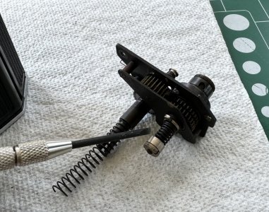

Not sure on that one. In some cameras the take up spools rotation changes (less rotation) as you get further into the roll to account for the diameter of that getting larger as more film is wound on. I don't think the HorizonT does this though but I might be wrong. I *think* it gets around this by being designed to slip a little. In other words when you get further into the roll the take up spool would be trying to pull more film than the sprockets allow so the take up spool slips a little to keep winding consistent.
What might be happening to you is the take up spool is slipping too early. There is a tension adjustment for the take up spool on the bottom of the winding mechanism that you take out from the top. I think that is what the spring loaded part is all about. Can't recall which way you adjust that for more tension though.

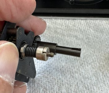

I adjusted the tension on the rotation contact spring (first image, pointing with the screwdriver) of the take up spool and it seems to have helped. Not sure how much tension is too much, I adjusted it by a couple of full rotations (shown in second picture)

As far as enough tension you want enough so that you aren't unloading but not too much that you end up tearing the film near the end of the roll from the take up roller pulling too much/too hard and the film tearing at the sprockets. .

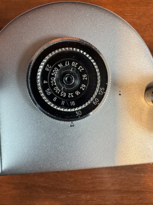

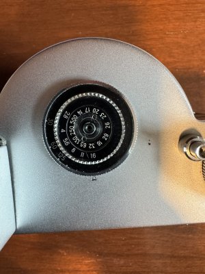

I noticed that even though the shutter speed dial clicks in smartly at the marked 30, 60, 125 and the unlabeled settings, the dial does travel a bit past those marks. There’s specially a lot to slop past the unmarked (500) spot.
Is this normal, or did I screw up in reassembly?
Maybe the attached pictures will show the amount of travel past the markers. There is no “click” at these extremities by the way.
What do you think?
What do you think?

I‘m no expert but the travel between the marks looks extreme (even by soviet standards). If it works, just leave it that way, it wouldn’t bother me.

Glad to hear you had two rolls feed properly. Biggest question now is if it has any light leaks which the film will show you pretty easily once it is processed.
If the click positions line up with the shutter speed indicators everything is fine. If they don't line up you misaligned the shutter dial gear a little. You can correct that by removing the top and tweaking the position of the shutter dial when you reassemble. Took me a couple of tries to get mine lined up properly for both shutter and aperture settings.

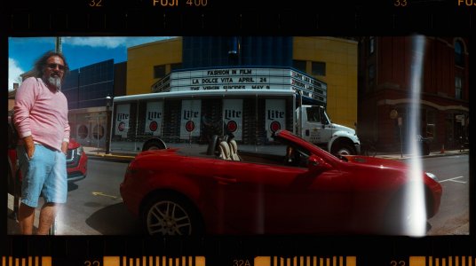

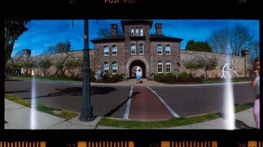

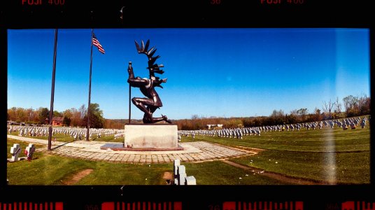

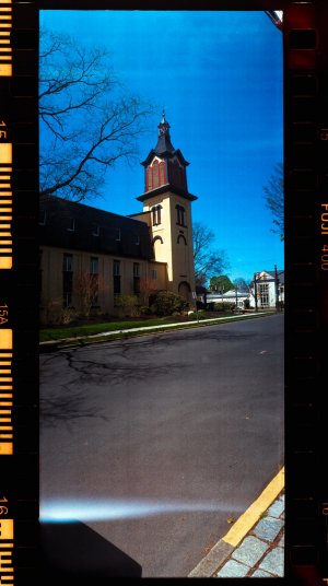

Time for an update
good news, two rolls of film went through the camera with no issues
Not so good news, light leaks.
Ugh. I had really hoped to not have to mess with this camera again since I was really pushing my abilities with the previous repairs.
Are these leaks from the light baffles on either side of the turret?

Yes, those are light leaks around the turret. This is from my early basket case HorizonT.Time for an update

Don't bother trying to replace them from the bottom. Bite the bullet and just pull the turret out. It isn't as scary as it seems and makes it dramatically easier to get new seals in there. The little bit tricky part is having the seals tight enough to block the light but loose enough to not impede the rotation.
Ignore the banding for now. If the old seals are gunked up that could be impacting the rotation of the turret.
