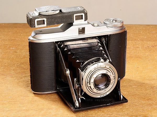

Here is my JsoletteV with Agnar. Converted to an RF camera by adding a Smena shoe-mounted rangefinder (originally meant to be on a Smena 1 or 2) of the same vintage. It helps for those critical close up focusing at f/4,5. But the business of focusing through the RF, then reading the scale,
followed by transferring the read value to the lens focus scale CAN be messy, clumsy, and awkward.
The added RF does not give much benefit. The fuss makes it obvious that going scale focusing is the better and faster way to go with this Jsolette. Come to think of it, the RF-equipped Agfa Jsolettes don't have their RFs coupled to the lens anyway. Or were there any which were?
