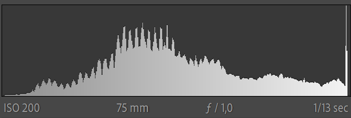

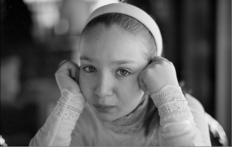

This is the picture in question:
With a 100% view:
And the following histogram:
The dslr scan (24mp):
At 100%:
Withe the following histogram:
There is some dust on the negative, and the dslr scan si a bit darker. It seem to me that "Particular" hit the nail on the head....but "everybody" claims to get better results with their dslrs than with their scanners. To me the eyelashes seemsbetter defined in the coolscan scan......and I see that might be due to bad focusing, but I focused as good as I could at 2.8 and stopped down to f8.0.
With a 100% view:
At 100%:

Scanner sensor have less dynamic range so there is less empty space in histogram.
