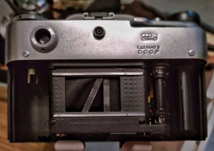

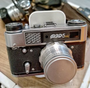

I've got couple Soviet RF, Fed 2, 5, Zorki 4K, Leningrad spring-powered auto winder. I specially like the Fed 2 it's classy, but unfortunately my copy has curtain leak, the photos it took were fogged. Then later I bought the Fed 5, it's 'modern' with a working meter, but the curtain broke and jam after I 'dry run' it to play around with. I found the curtain is not like the Fed 2, the Fed 5 one has rubber coating I believe like the Pentax Spotmatic that I don't have, people said it is very reliable, and I am certain it will not leak. Since the camera is still very good condition, I wonder if it is easy to replace the curtain ? and is there anyone has practical experience replacing/fixing the curtain on Soviet vintage RF ?

I think your curtains are ok but one ribbon probably „unglued“ itself. If you are able able to get to the shutter, it is probably just a matter of attaching the ribbon to the rollers/drum. No need for new shutter material.
I agree on this, the bottom ribbon has either come unstuck or broken (a third possibility is that it has somehow become unhooked from the lath but that is unlikely). If it's broken a new ribbon will be needed but otherwise it's just gluing. With a bit of luck and care it may not even be needed to de-tension the rollers.
Thanks for the tip that's comforting ! I have some experience fixing Soviet RF like adjusting the RF and cleaning, especially the Fed they are simple in design, much simpler than the Keiv, so I will give it a try to fix the ribbon, what kind of glue to use, the type for leather ?
A liquid neoprene contact adhesive should do the job. Brands vary by country but it mostly similar stuff. This should be the ribbon attatched below the main drum.
Probably you can curl a thin strip of paper and feed it behind the drum and then use it to drag the ribbon into place. You will need to half cock the camera such that you can see both laths then pull the ribbon such that the two laths are parallel and overlapping. Be precise!
Of course, all of this assumes that the other first-curtain ribbon is soundly attatched.

I just took a look at a FED 4 which is probably similar (anyone correct me if I'm wrong). I have never taken one apart but it looks like you will need to remove some parts of the Self Timer and then the front cover. There appears to be a lower baffle which will have to be removed; this will probably give you the access you need but I'm not sure about the slow speed escapement. Look at a few web sites before you decide on whether to tackle it. I have done similar ribbon jobs without a full disassembly but only on basic Leica and clones (Zorki, Nicca) and the casing is different as there is a single piece body shell.
