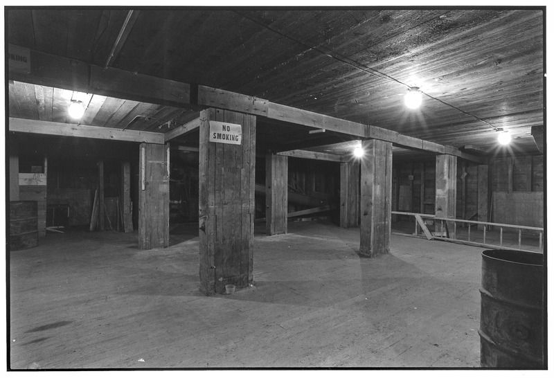

Perceptol 1:1 for 12.5 minutes, with 2 inversions of the tank every minute is my standard. I used this combo for an extreme contrast situation, inside a windowless old grain elevator with bare light bulbs in the frame. Kept the light bulbs shape and managed to get detail in the wood walls even in wide views. I bracketed a bunch, as I went into it knowing I was going to do such an extreme pull. I have since used this time when I've made the same mistake as you, perhaps 11 minutes and more standard agitation would be good if you aren't needing to control high contrast.

Here are some quick scans of a couple of those off the proofsheets:
They are still challenging to print, but very possible.
