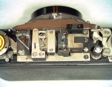

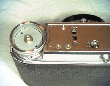

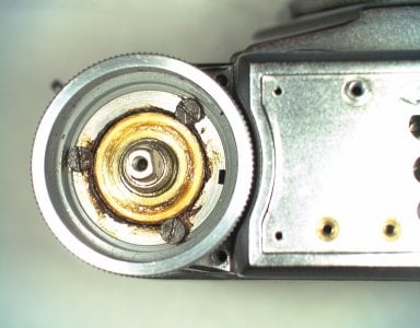

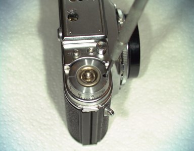

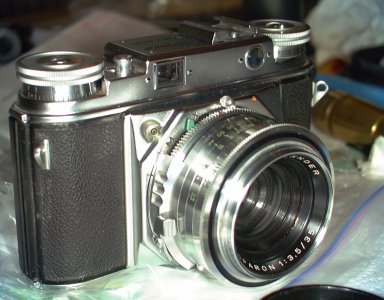

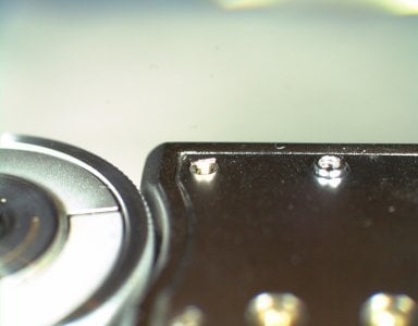

On my camera- the RF return arm was broken. I took a lot of pictures when I repaired that in 2007.
DSC00032.JPGDSC00033.JPGDSC00034.JPGDSC00036.JPGDSC00037.JPGDSC00038.JPGDSC00039.JPGDSC00040.JPGDSC00041.JPGDSC00042.JPGDSC00043.JPGDSC00044.JPGDSC00045.JPGDSC00046.JPG
