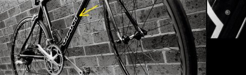

Sharpness, SDIV is sufficient for me but the only other dedicated film scanner I've used is Polaroid Sprintscan 120 for my 6x6 shots - the scanner isn't mine. Attached is an XPan scan of TMax 100 - take a look at that small dot indicated by yellow arrow.

Have I found an RFF buddy? I love the shot of the bike with the telltale arrow to the dot. Great resolution.
